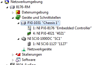

In MAX under network devices the configured system should look similar to this,
if not you have to check the configurations
Then you have to creata a new project in LV with the RT target like this
