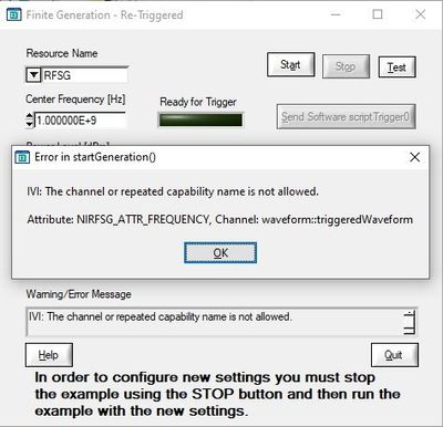

The issue is I'm always getting the following error:
IVI: The channel or repeated capability name is not allowed.
Attribute: NIRFSG_ATTR_FREQUENCY, Channel: waveform::waveformname
I have tried to set this by calling these functions through CVI c program and also via  ni's grpc-device server using python.  Each time it's the same error.  I couldn't find any CVI c examples that accomplish this however there is an example in the ni grpc device repo that does exaclty this however when I try to run it I just get errors.

 However this is the error I get:
I attached this example so that you may try it, or maybe I am doing something wrong?
There is no mention anywhere that this functionality is not supported on the PXI5670 however no matter what I try I cant do it.  Does anyone know why this may be?  Is the documentation just wrong and doesn't state that this is not supported on some models?   Is there a specific order that needs to be followed?  I have tried just about anything I could think of with no results.
