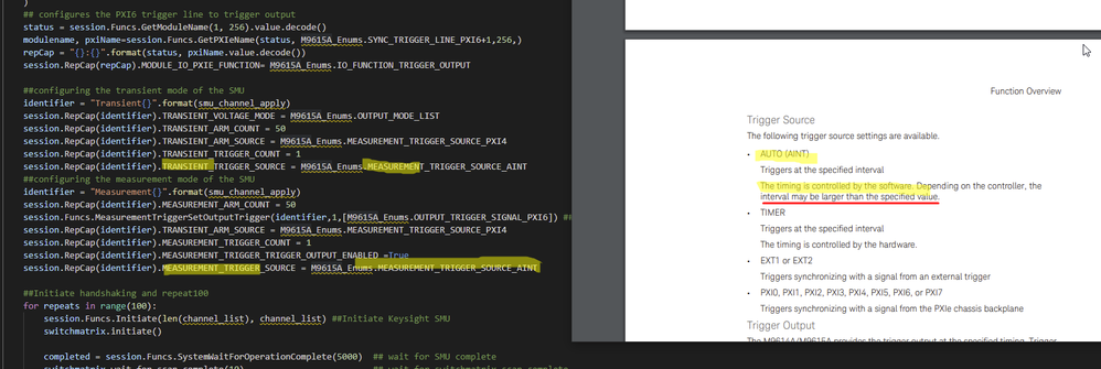

I apologize for the late response. I had been trying synchronous scanning instead of handshaking, which seems to work if the timing was set properly. I would still like to solve the problem of the handshaking timeout, so I have attached a snippet of the python code used for operation.
For the repeat x100, steps 2-7 are repeated. The reason for reconfiguring the switchmatrix is that while the same exact switchcolumns are used, they are connected to different SMU channels depending on the polarity of the voltage applied. For clarity, the attached snippet only shows a set scaneventlist, where the actual code generates a new one every repeat. The syntax is identical, but if you would like to see that code as well, please let me know.

A quick review of the code does not reveal any red flags. The next thing would be to isolate the root cause whether the SMU or the Switch matrix because both are interdependent on the handshaking triggers.

The interesting thing about this SMU is that it has an ARM layer, followed by a TRIGGER layer. When initiated, the system enters the ARM layer and waits for an event. When the scan advanced output is received from the switchmatrix, the ARM moves into the TRIGGER layer, where the event that determines the device action (applying voltage) is controlled by the trigger source AINT. I suppose it is possible that timing during this step is causing an issue, but the measurement complete signal is not sent until the SMU returns to the ARM layer. Like you said, it may be an incorrect trigger configuration.
