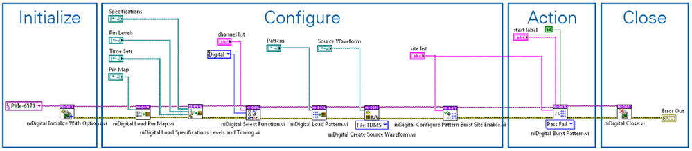

So, I have two 6571 that I'd like to run from LabView. The thing is that with LV, I can make some tests run automatically. Is there any example how to configure basic set-up for two 6571 in LV.
Below is the single 6571 LV configuration. Since the pattern file shares pin's from both cards I'm not quite sure how to connect the second resource to work correctly.
Thanks!
(1,964 Views)
Accepted by topic author Sruk

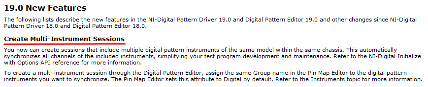

You just need to provide the instrument aliases as comma-separated in the resource name during initializing.
NI-Digital 19.0 and above supports multi-instrument sessions, this means the driver can treat multiple instruments as one large instrument provided they are in the same chassis and of the same model.
Santhosh
Soliton Technologies
(1,958 Views)
