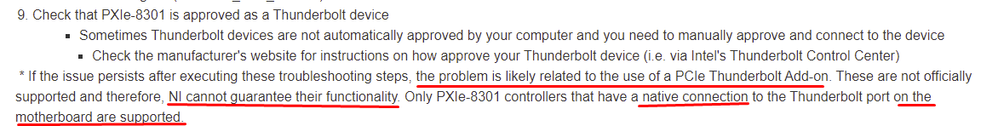

https://knowledge.ni.com/KnowledgeArticleDetails?id=kA00Z0000004BA0SAM&l=en-US
This article has a fine print that says NI does not officially support PCIe thunderbolt cards and only motherboards with native thunderbolt are supported.

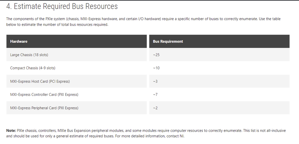

https://knowledge.ni.com/KnowledgeArticleDetails?id=kA03q000000YHwZCAW&l=en-US - This article explains determining the number of root busses available.
https://www.ni.com/en-us/support/documentation/supplemental/14/understanding-mxi-express-enumeration... - This article states the number of root busses required for each type of chassis.
