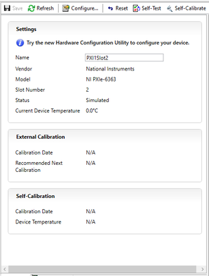

What do you mean by the chassis number? There is no chassis number in NI MAX. Do you mean the PXI1Slot2 in the Name field?

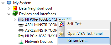

Interested in updating the actual chassis number under Devices and Interfaces:
This can be done manually in NI MAX with a right-click of the chassis and selecting Renumber...
I'm interested in doing this programmatically.

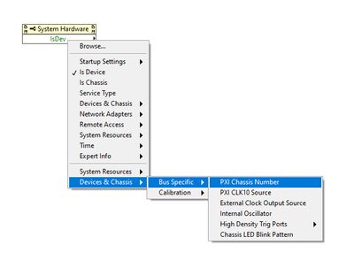

You can do this with a System Configuration Hardware Property node.
You may need to update PXI Platform Services to get these properties to show up.
