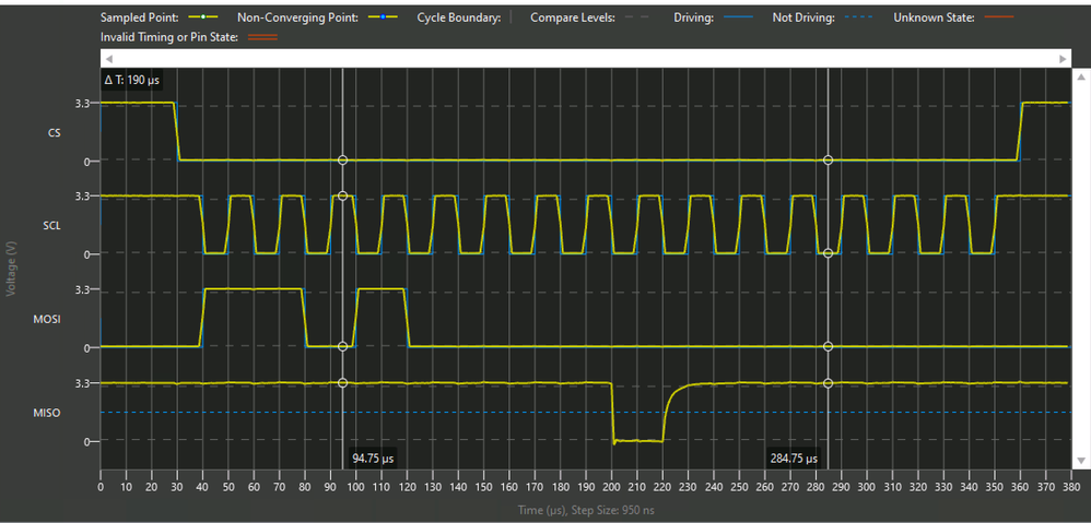

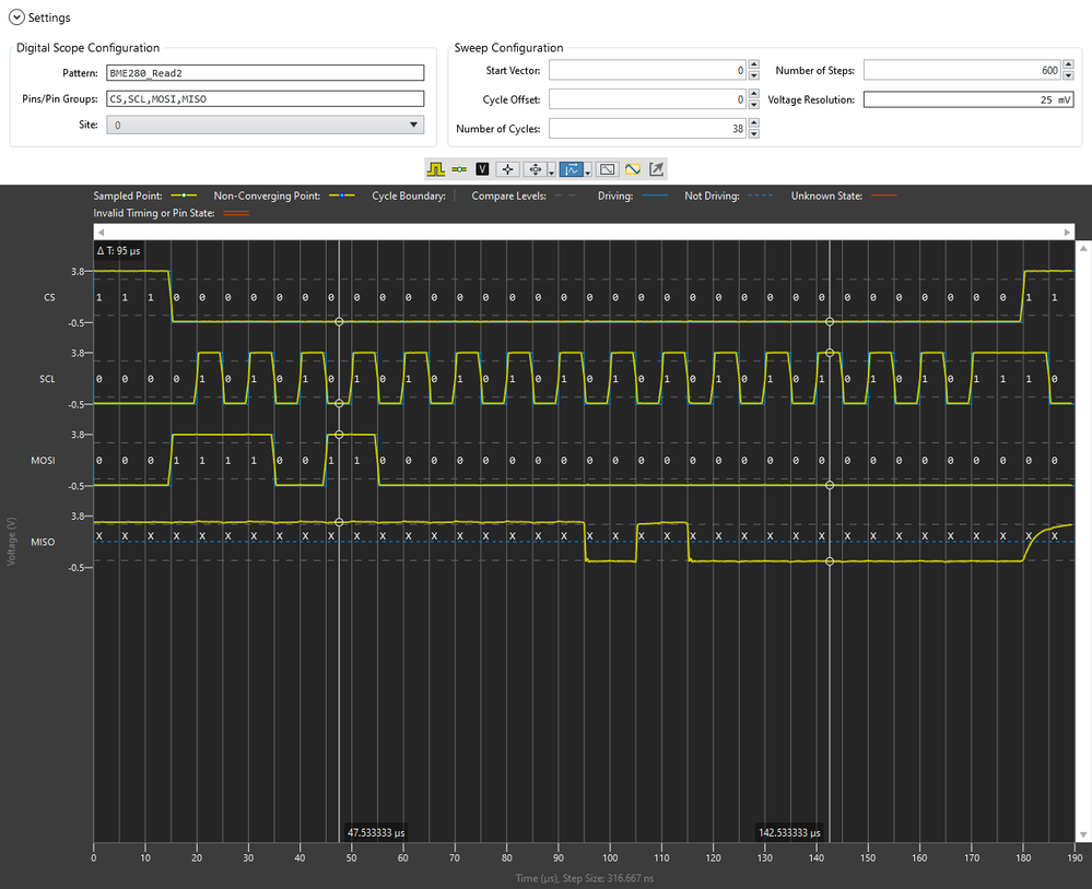

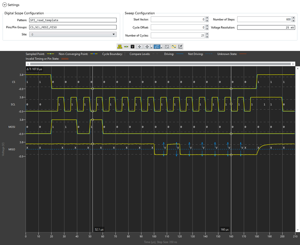

I tried to bit-bang this using only 1s and 0s in the pattern (left image) as well as use the template to do a read command (right image), but neither yielded 0x60.

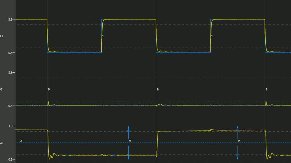

If I make the number of steps higher I can see that the clock has the potential for an issue:
First stage:

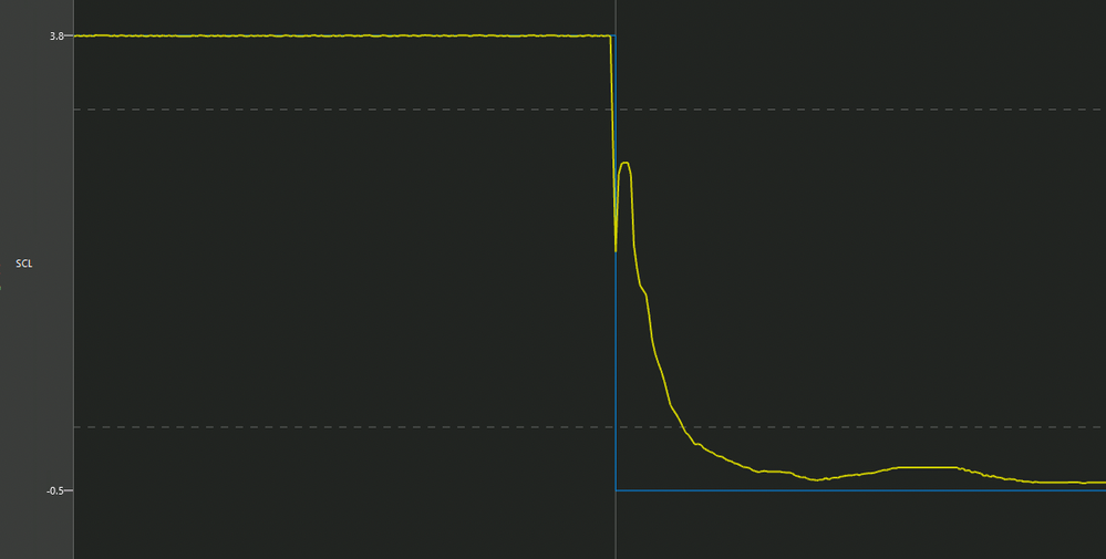

Zooming in to the falling edge of the clock, where there's a second rise that might be seen by the device. (the datasheet says the sensor can work work at 10MHz so I fear this really could be a potential issue):

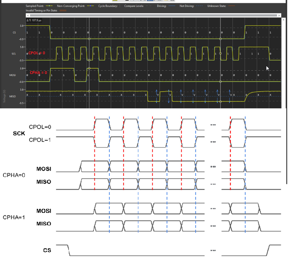

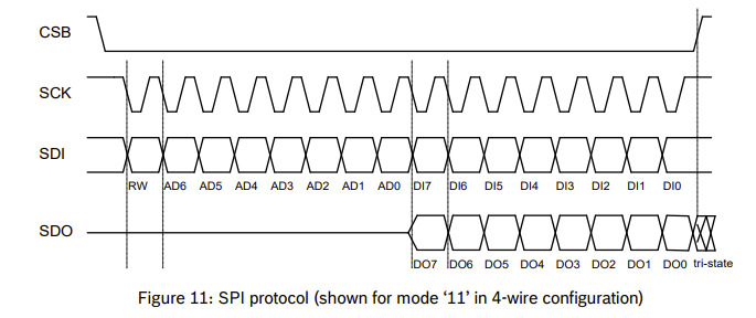

Waveforms look good and you're using CPOL = CPHA = 0 which is supported by the DUT.
I would recommend trying the CPOL = CPHA = 1 shown in the datasheet,
TDR would not make a significant impact at the slow speeds you're operating (100kHz).

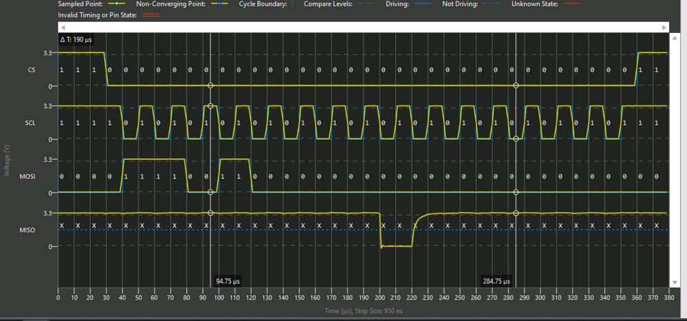

Thank you Santhosh,
Especially for looking over the datasheet.
Here's my latest attempt at mode 3, pretty much the same output:

At least from the pattern side, the implementation is good.
Few questions,

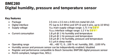

  • Why do you drive the signal between -0.5V and 3.8V for CS, SCL and MOSI? this exceeds the VIO levels supported by the DUT
  • How are you powering up the DUT? at what levels?
  • What is the exact circuit connections?
  • Please share the order of steps you're following to run this pattern
    • Like, power up VDD at 3.6V, then VIO at 3.6V, then run the pattern etc.,

Ah, you caught me with some debugging parameters in place.
Like I showed with the picture, I was worried about there being an extra rising edge and was hoping to avoid those oscillations with a bigger separation between high and low. I run this device at a VCC of 3.3V. I know I keep mentioning oscillations but when I use 3.3V and 0V as the high and low. Here's the pattern I get, so increasing the separation seemed to be a step in the right direction:
The Arduino actually has a high of 5V and a low of 0V. For the same Clock, MOSI, and Chip Select pins.
The sensor datasheet was only used for the SPI information. The sensor is actually on a board provided by waveshare: https://www.waveshare.com/wiki/BME280_Environmental_Sensor
Currently, the board is powered up via an NI 4144 SMU to 3.3V, it's also controlled by the digital pattern editor.

I had forgotten the settings I had left the program in because I've been debugging. There's some important information in why I drive with that as well. If I drive with 3.3V and 0V I get the following:
So I thought increasing the voltage between high and low would help with the false clock reading I mentioned before. And it seemed to help, after all, I get something that seems better as shown in my original post, and I had been going with that. What's more, is the Arduino uses 5V for these pins with a 3.3V supply. Even though it's not best practice to go higher than rail.
