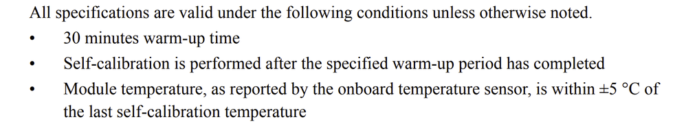

I counted 18 instances of  the term "self-calibration" and "temperature" either preceding or subsiding the former search term in the PXIe-5830 specifications.  All the specs are valid when self-calibration procedure performed.
(1,217 Views)
You would need to perform self-calibration whenever the onboard temperature deviates 5 degC from the last self-cal temperature. To make things simple, you could do this before every critical measurement execution probably every day or every shift.
As per the specification conditions, if your instrument temperature is maintained within 5 degC you can even use the instrument for a full year to match the next calibration cycle due.
