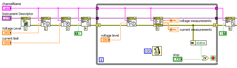

hallo everyone ,
I changed the DC power example , the Goal is to add everytime  1 to the input Voltage and to measur the current of the sensor ,
so the first thing what i did , I put all the icons in  " while" and I try to run the Prog.  It dosn't work !!!! BUT if I turn on the Highlight Funktion it works .
I am a littel bit confused , I don't know what  to do . I need help plz
To understand what I mean I attached the .Vi
Toni
(4,106 Views)
Hi Toni,
I am assuming based on your second post that you were able to find and get the NI-DCPower examples working. If I understand your problem, you are using the NI-DCPower Generate Example, but you want to continuously increase the voltage being output by the power supply in 1 V increments and monitor the current being output at that voltage. Is my understanding correct?
I took a look at your VI and I noticed a few things that might be causing your error. First, there is no time wired to the Delay Express VI in the while loop, which means that there is no wait being applied. This could be why your VI only works when highlight execution is enabled. I would also suggest using an actual Wait Function instead of the Delay Express VI.
Secondly, I think that modifying the example program as seen in the attached screenshot will be better programming practice and resource management. In your VI, by placing the while loop about the entire program, you are continually having to configure and close driver sessions which can significantly slow down your program and is most likely what is causing your current difficulties. By adding a second Configure Voltage Level function inside the while loop, you will be able to continuously vary the voltage being output.
I hope this explanation helps. Regards, Mallori M.

Hi Mallori ,
Thank you very much , it works    Smiley Very Happy
