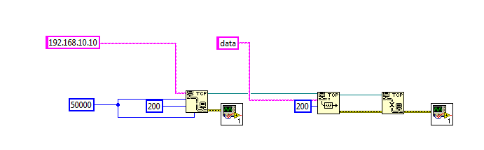

Using TCP on the second ethernet interface
For the "UDP Open", I set the input "port" to "0" to let the system choosing a port. For the "UDP Write", I use a fixed port (50001)
For "TCP Open" I use (50000) for "remote port" input and I didn't plug the "local port" input (to let the system choosing a port)

I simplified a lot what I'm doing but everything regarding the TCP is here.

it's the client part you send me. thanks
Does the code in the server part use Labview?
If yes, do you have it?
Message 17 of 21
(3,241 Views)
The server part isn't using Labview, its coded in C.
My code is in a Versitand Custom Device. If I run the custom device on localhost (my windows laptop which has only one ethernet port), everything is fine and the Custom Device is able to communicate thourgh TCP. The problem only occurs when the Custom Device is running on the RT Target (because there are two ethernet port I guess).
