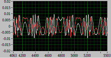

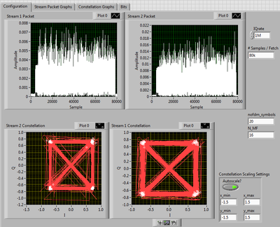

 These are the result of received signal that is transmitted by two USRPs, and the part of the received signal.

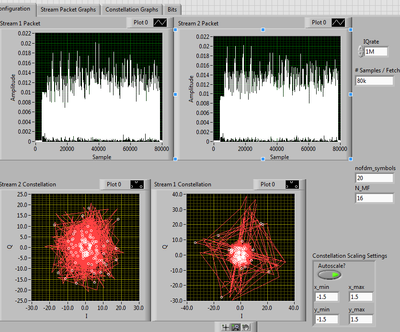

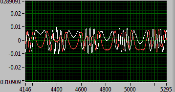

  These are the result of received signal that is transmitted by two VSTs, and the part of the received signal. It looks like mix some low frequency signal compared with above signal.
