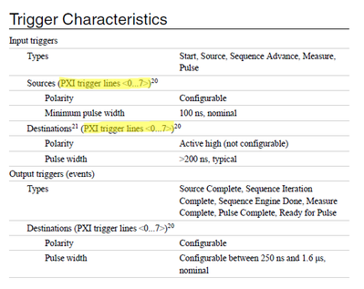

Regarding external triggers for 4139 and 4137 - there are no terminals for external trigger signals except the PXI trigger lines <0..7>.
As long as both the 4139 and 4137 are on same chassis or (daisy-chained multiple chassis) you do not need additional software to route triggers.
You need to look into exporting triggers from 4139 and importing triggers to 4137 through PXI trigger lines.
