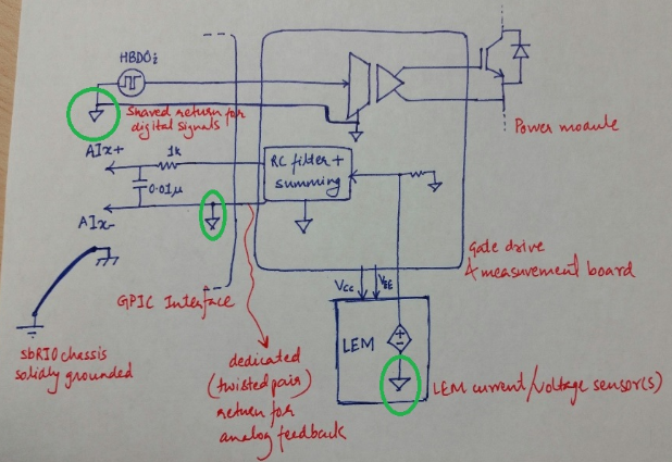

BMac,
Please see attached for a simplified schematic. Let me know if more information/explanation is needed. I can also make common-mode voltage measurements if there are any specific points on the sbRIO/GPIC you want probed.20140918_130415_resized (1024x576).jpg

LabviewingToday-- Our engineers have taken a look at your diagram and there are some possible grounding conflicts as shown below (green circles). Also, there are some incomplete/missing items in the diagram that we will need. I'd suggest a web conference to discuss. Please email me (brian.maccleery@ni.com) with a few suggested times for a web conference this week.
Note:
- It would be good to describe a little better the GND connections you have between the power module and the rest of the system, including the PC you are using. I am assuming those tie together somewhere.
Message 9 of 13
(6,029 Views)
BMac,
Sorry about one error in the diagram above. We are not actually grounding the AIX- pin. I will send you an email with the ground connections, block diagram and my preferred time.
