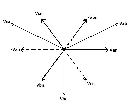

This NI app note does an okay job of explaining the Line-to-Line Voltages and Line-to-Neutral conversions... which is summarized by the phasor diagram drawing below.
http://www.ni.com/cms/images/devzone/tut/image38959.jpg
Starting with Van as angle 0, let's go around it counter-clockwise-- the direction of leading (positive) phase angles:
1. Vab leads Van by 30 degrees and has an RMS amplitude that's sqrt(3) or 1.73 times larger.
2. Vcn leads Van by 30+90 = 120 degrees.
3. Vca leads Van by 120+30 = 150 degrees and has an RMS amplitude that's sqrt(3) times larger.
4. Taking the shorter path, Vbn lags Van by -90-30 = -120 degrees.
5. Vbc lags Van by 90 degrees and has an RMS amplitude that's sqrt(3) times larger.
