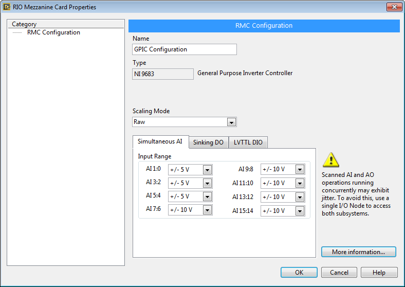

To set the analog input to Raw integer mode, right-click on GPIC Configuration under the FPGA target in the LabVIEW project and set the Scaling Mode to Raw. You can also configure the analog input range to +/- 5 V or +/- 10 V to achieve the best resolution based on the voltage range of your sensors.
