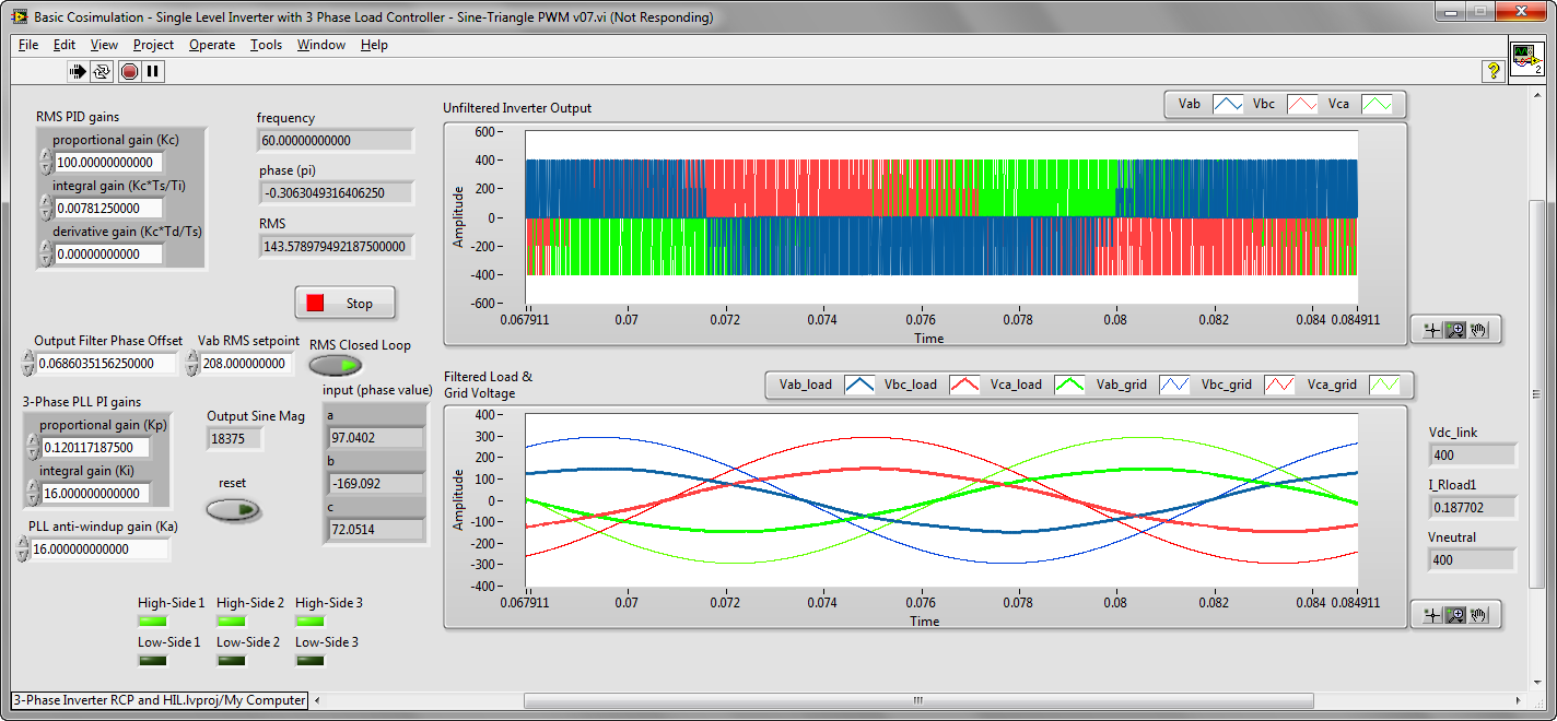

Basic Cosimulation - Single Level Inverter with 3 Phase Load Controller - Sine-Triangle PWM v07.vi: This is a basic co-simulation application to verify the control system logic with Multisim. This runs faster because it doesn't have the fixed-point state-space model in it. Use this to design and test new control algorithms on the desktop before compiling them to the FPGA for rapid control prototyping. Note that the same LabVIEW FPGA IP cores are linked in this desktop application and in the LabVIEW FPGA control system in that part of the project. If you change the algorithm in one place it is automatically updated in the other, and may require a recompile. For example, if you edit "IP Cores/FPGA DDS TriangleGen IP.vi" in your cosimulation application, it is automatically updated in the FPGA RCP loop. If you want to run an older version of the LV FPGA application, just like to the bitstream file rather than the VI and you won't be forced to recompile before running. However, your desktop co-simulation algorithms will no longer match the LV FPGA RCP algorithms.

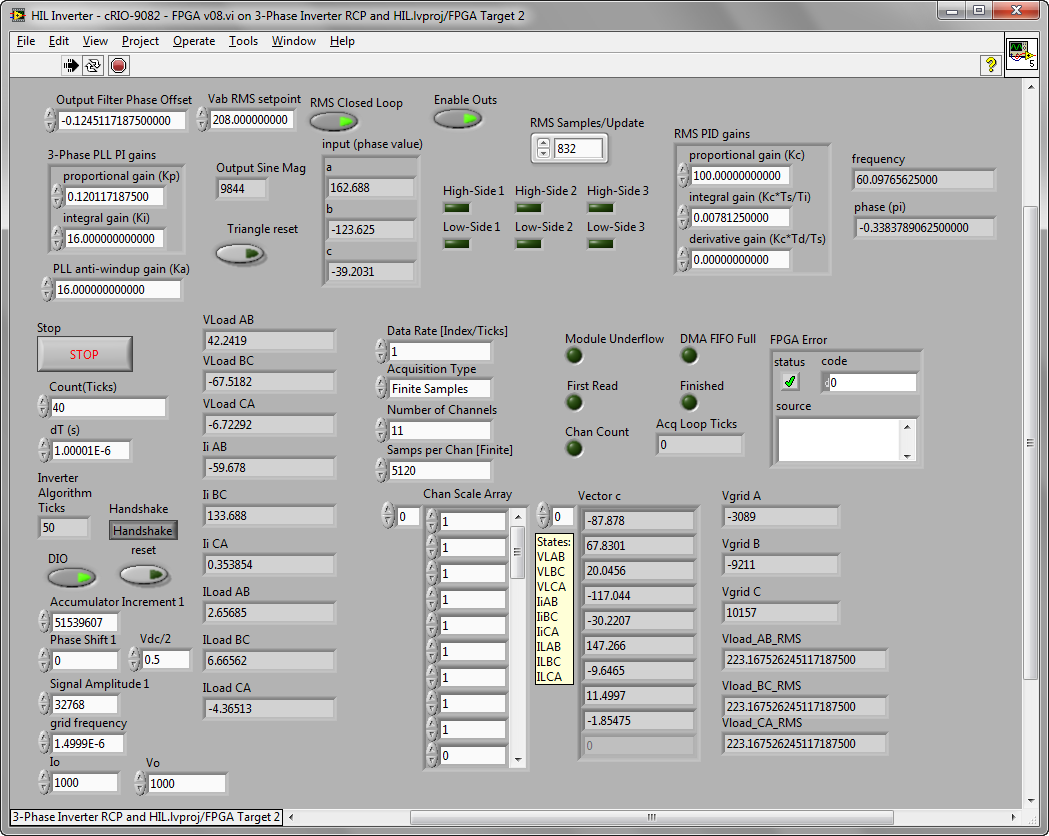

3-Phase Inverter RCP and HIL\HIL Inverter - cRIO-9082 - FPGA v08.vi: This is the LabVIEW FPGA application that contains both the control system code and the inverter HIL simulation code. If you want faster compile times, use a dedicated FPGA target for the HIL simulation so you only have to recompile when changing the control system code. This takes about 1.5 hours to compile on my relatively slow laptop. If you do all your development and code verification using the desktop co-simulation environment, you won't have to compile to FPGA very often.

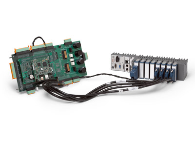

Below is a photo of the NI Single-Board RIO HIL setup in the table above. (However, a different version of the mating PCB is used.) As you can see, all 16 analog inputs on the NI sbRIO GPIC are connected to analog outputs of the Multicore CompactRIO HIL system. The HIL voltage outputs are scaled to match the signal scaling of the LEM current and voltage sensors of the physical inverter, so the sbRIO GPIC system "thinks" it's connected to a physical inverter. Here is a template for the inverter control code that runs on the sbRIO GPIC (tutorial and download). The gate command signals are sent both to that half-bridge digital outputs and LVTTL digital lines that are connected to the NI 9401 module in the Multicore CompactRIO HIL system.

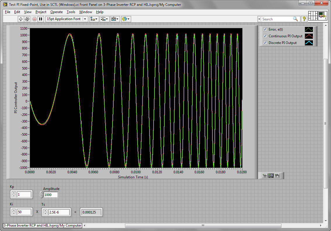

Test PI Fixed-Point, Use in SCTL (Windows).vi
Block diagram of PI control algorithm that executes in a single clock tick of the FPGA:

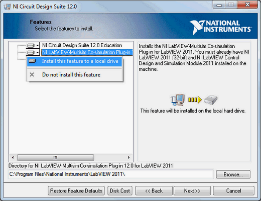

Hi
Where I Found this file "MultisimEMICtrl.dll"
and how solve this Errors:
An error occurred in compiling this VI.
Error -2367 occurred at External Model
Possible reason(s):
Control Design and Simulation:  The shared library corresponding to the external model returned an error.
Unable to load library.
Message 3 of 9
(16,059 Views)
Hi Sammak,
Most likely you don't have the NI Multisim Co-Simulation Interface installed. This is an option when you install Multisim- be sure to install NI LabVIEW 2011 SP1 and the NI Control Design & Simulation Module first, and then install the NI Multisim Full, PowerPro or the NI Multisim Education Edition. See this tutorial for screenshots of the installers, where you can see the option to install Co-Simulation.
Note: Co-Simulation is not supported with NI Multisim Base.
The software installer download links are here.
http://zone.ni.com/cms/images/devzone/tut/mclrctpj8226354498210247612.png

Congrats on receiving your NI Power Electronics RCP & HIL Bundle! There are three primary options for connectivity between the NI sbRIO GPIC control board and the cRIO-9082 HIL simulator:
1. Use the open source mini-scale back-to-back converter research kit (available from Bloomy in the United States, Schmid Elekronik in Europe, and SVTronics in other countries). To connect it, remove analog input jumpers from the inverter research board and connect the analog outputs from the cRIO-9082 to the simultaneous analog input connector for the NI GPIC control system. This is the recommended choice if you want to compare simulated versus physical measurements or perform system ID using a mini-scale plant connected to the mini-scale converter board (i.e. 3-phase induction or PMSM/BLDC motor or dynomometer from MotorSolver, line reactor filter, solar panel, battery, wind turbine, etc.) See below for details.
2. Use the open source SEMIKRON SKiiP3 interface board (available from SVTronics worldwide). This is the recommended choice if you want to connect to a full scale (50 to 125 kVA) 6-pack IGBT power converter such as the SKiiP3 from SEMIKRON or the SmartPower Stack from Methode Electronics. Note: The latest rev of this board has jumpers that enable you to disconnect the SKiiP3 sensor signals (phase currents, DC link voltage, temperature) from the GPIC analog inputs, so you will not need to disconnect the SKiiP3 connectors if you want to connect the interface board to your NI 9082 HIL simulator analog outputs. However, in most cases, you will still want to disconnect the full scale converter to disable its operation during HIL testing.
3. Use ribbon cable connectors to interface to the NI 9683 GPIC I/O board directly. In this case, you may wish to use a ribbon cable to screw terminal accessory to simplify wiring between the sbRIO GPIC control system and the cRIO-9082 power electronics HIL simulator.
Here are more details on option 1 and 2 above:
Note that electrical signals scale down linearly for the most part (transmission lines are an exception), so the mini-scale converter system is like an analog simulator for full scale power converters and power systems. R&D teams use multiple of these mini-scale converters, for example, to build microgrids with multiple asset types (i.e. gensets, wind/solar, storage converters) and power flowing between each of the converters. The software developed for the mini-scale converters is identical to that for a full scale converter (i.e. SKiiP3) with the exception of the scaling/gains and fault trip limits. All of these values are stored in FPGA RAM, so you don't even need to recompile the FPGA when you move back and forth between the mini-scale converter and the full scale.
You can do a fully digital HIL system where all of the signals are simulated. Optionally, utilizing a mini-scale physical inverter board like the kit from Bloomy or a full scale converter enables you to validate your digital simulation with real-world data.
See here for technical details on the mini-scale inverter board. Note that it is designed with jumpers (on the bottom side of the board) that enable you to disconnect the GPIC analog inputs from physical voltage/current/temperature sensors and connect them to analog outputs from your cRIO-9082 HIL system that represent simulated voltage/current/temperature values (from the NI 9263 analog output modules) . Also, the PWM gate command signals for the power converter are buffered out through the LVTTL lines on the GPIC for connection to the NI 9401 TTL digital input modules on your HIL system. If you want to disable the power inverters on the mini-scale converter board, just disconnect the +15 VDC supply (round barrel connector) from the inverter section of the board-- this disables the gate drivers for the physical inverter chips.
Thus, using the mini-scale converter board you can operate in two different modes:
1. "Completely digital sandbox." In this case all of the inputs and outputs to the NI GPIC control board are based on simulated signals from the NI cRIO-9082 HIL system. Therefore the analog input jumpers are removed and the analog outputs from the NI 9263 modules are connected to the mini-scale converter analog input connector. This is classical HIL simulation.
2. Simultaneous execution of HIL simulation and physical control. In this case, the physical signals are measured by the mini-scale converter board This is useful for system identification. The same control signals are sent both the cRIO-9082 HIL simulator and the physical power converter (mini-scale converter research board or full scale converter). Example code is available that demonstrates the use of a global optimizer to drive the difference between the measured and simulated signals to zero by automatically tuning the HIL simulation parameters. This is demonstrated for a buck-boost battery energy storage converter, a full bridge linear motor converter, and a magnetic levitation power converter. A real-time FPGA-based floating point simulation of the power converter and the physical plant model is included for each of these examples. The real-time power converter simulation model for the IGBT half bridge includes temperature modeling, as well as energy efficiency (download code or read white paper).
I hope this information is helpful. Please reply if anything is confusing or if you have any follow up questions.
