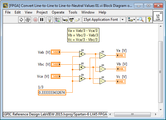

I'm assuming you have checked that the voltage signals are in the correct phase sequence. The most common problem people run into with PLLs is having the channels wired in the incorrect phase sequence. Also, check that your IP core that converts from line-to-line to line-to-neutral is correct. I've attached an example, which is located in the master library here (C:\LabVIEW 2015\IP Cores\IP Cores - LabVIEW FPGA\Analysis\[FPGA] Convert Line-to-Line to Line-to-Neutral Values 01.vi).

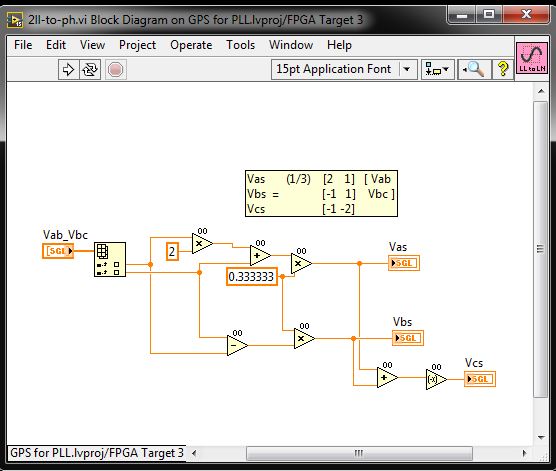

I like to build my own subVIs myself  as I like to know everything that's going on in my codes. So I didn't use the VIs that are available in the power electronics guide folders. Below is the VI that I built to convert from line-to-line to Phase voltage.
The VI above assumes a balanced system.

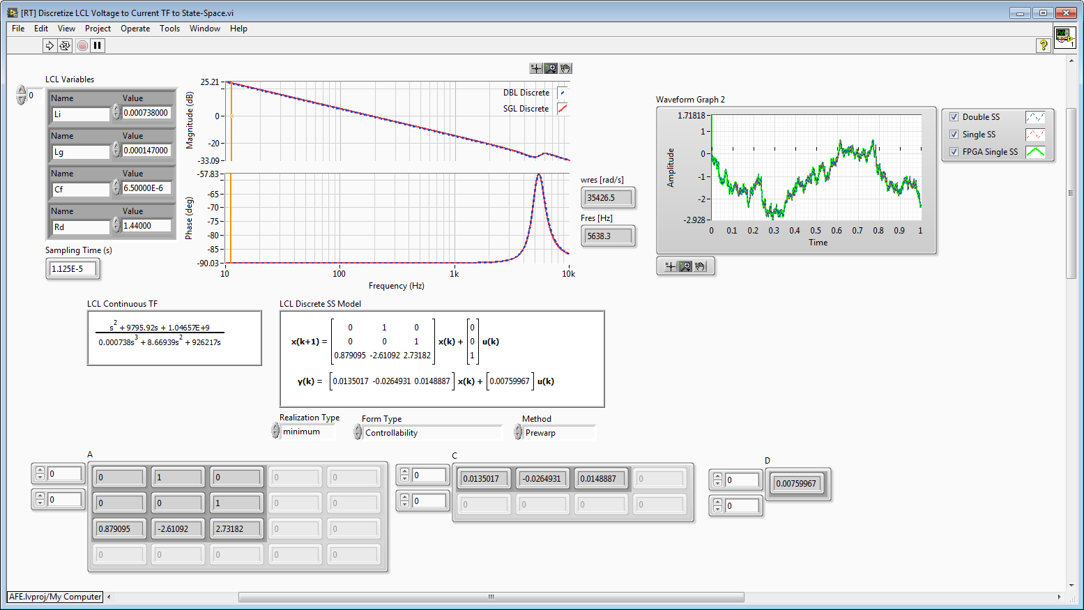

If you consider the loop gain phase delay for your converter (Setpoint>Control Algorithms>PWM>Converter Gain>Half-Bridge Voltage>LCL Line Reactor Current>Sensor>ADC), the phase shift associated with the analog input modules is likely to be a small fraction of the total phase delay. Typically, the LCL Line Reactor Filter dominates the phase shift by adding -90 degrees of phase shift from voltage to current. The transfer function frequency response for an LCL line reactor filter from inverter half-bridge voltage minus grid voltage to inverter phase current is shown below. The code and real-time simulation model for the FPGA-based LCL filter simulator are attached.

Note that the state-space solver that simulates the LCL filter in real-time is designed for IP Builder. Thus array constants are used which are converted to FPGA RAM by the compiler.
The input delay calculation for your modules, in seconds, is (40 + [5/512])/fs + 3.2e-6, where fs is the sampling rate for the modules. At 50 kS/s that's a phase delay of 803 microseconds. That's 4 percent of a 50 Hz output frequency or 14.46 degrees. It is significant, but it is 6.2 times less than the phase shift caused by a typical LCL line reactor filter with regards to current regulation.

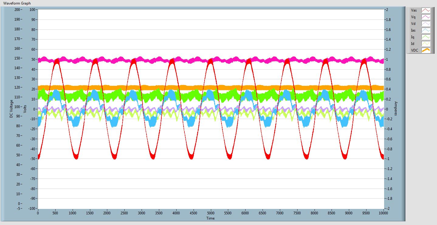

I have one last question. I want to save the transient response of my rectifier in an excel sheet. Below is a screenshot of my rectifier working. For safety purposed I lower the AC voltages to 50V peak per phase and commanded 120V to the DC Bus. Because I had a very small DC-load  (1kOhms) there is a lot of noise in the waveform. But things have improved since I took this screenshot. Now at 208V L-L, 350Vdc and 100ohms DC-load, the noise is much less and the current is much much smoother.
However, I want to record the transient response of my circuit during a step change. I can see the response on the plot for a fraction of a second then it disappears. Is there a convenient way to store the transient response plot and export the data to an excel file?
