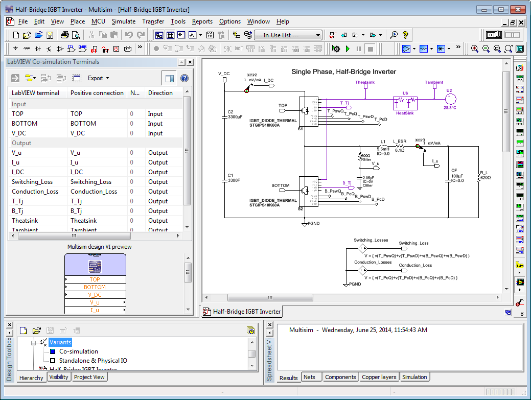

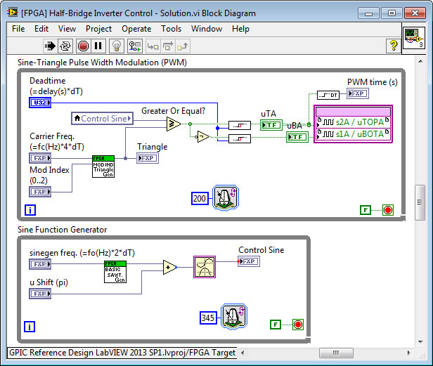

For the older Power Electronics Design Guide examples, keep in mind that they were written before the release of the LabVIEW FPGA Desktop Execution Node. Now you simply right-click on the FPGA target, set it to simulation mode, and you can run the FPGA control application in simulated time that's automatically step-by-step synchronized in closed loop with the Multisim power electronics simulation, as shown below.
Co-simulation with FPGA Desktop execution node and Multisim co-simulation node.png
To enable high fidelity co-simulation, the LabVIEW FPGA Desktop Execution Node interfaces to the LabVIEW FPGA Application while the Multisim Co-Simulation Interface connects to the power electronics circuit model. A desktop testbench application is shown above.
The Multisim power electronics circuit (top image below) and LabVIEW FPGA control application (bottom image below) are co-simulated with a common sense of simulated time.
Co-simulation with FPGA Desktop execution node and Multisim co-simulation node - MULTISIM.png
Co-simulation with FPGA Desktop execution node and Multisim co-simulation node - LABVIEW FPGA.png
