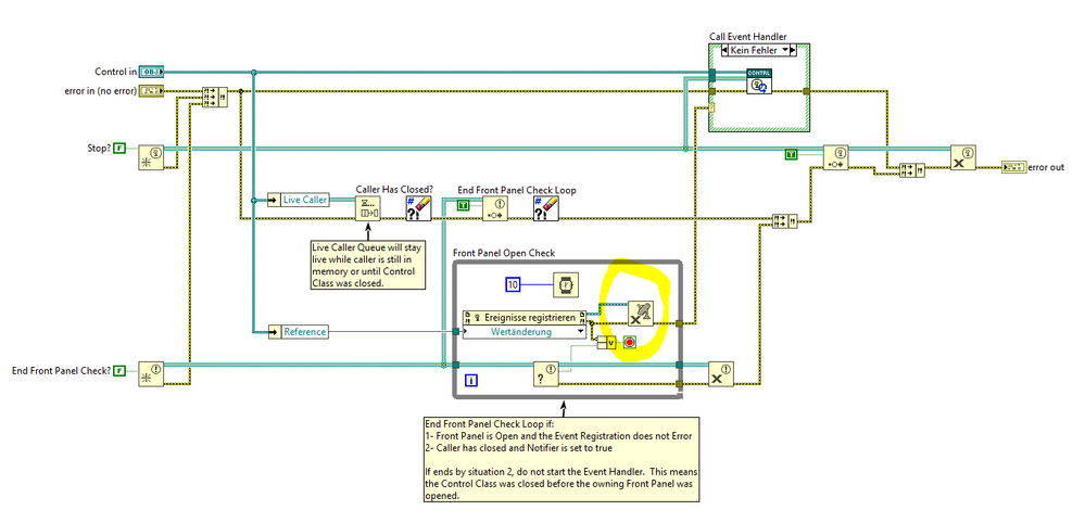

After a while and a lot of searching I dived into the Event Handler Dispatcher.vi and figured out, that the reference of "Control in" registers a new event every 10 milliseconds until the frontpanel opens, without using it. The while loop analyses the error output, until the event registration doesnt fails anymore. After that, only the last event registration gets destroyed. All other references get kept in memory and keep growing, if the frontpanel do not get opend.
Is there any reason for keeping the event registration references in memory?
If not, I suggest to destroy every single event registration reference, after evaluating the error, even if the registration fails.

My change:
new.PNGnew
I did this modification and now, everything is fine.

I remember you sent me a message about this a while ago. I apologize, I have implemented your fix in the next release but I have not got it out the door as yet.
An explanation to other users: you will want to implement @bheemann's fix if you launch a VI owning a QControl but don't immediately show it (i.e. launch the VI and at a later time show the VI in a subpanel).
The VI shown checks that the front panel of the VI owning the QControl is open before launching the event handler.  This keeps the dynamically called events in the event handler from causing an error on registration.  If the front panel of the VI owning the QControl is opened immediately then only one reference is created and it is closed.  The problem arises when the front panel of the VI owning the QControl is not opened immediately; then many references are created but only the last one is closed.
As I said, I'll have this fixed in the next release.
