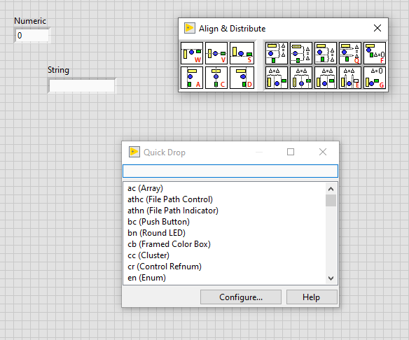

Firstly press CTRL+SPACE to open the quick drop dialog, then press CTRL+A to open the plug-in dialog containing the alignment and distribution buttons. The different buttons can be pressed to move the objects.
At the end the dialog can be closed by clicking on the close button in the corner or by pressing the ESC key.

After selecting some elements press CTRL+SPACE and CTRL+A to open the dialog window. Afterwards you can use one of the following keys to execute the wanted alignment:
  • W: Top
  • S: Bottom
  • A: Left
  • D: Right
  • C: Horizontal Center
  • V: Vertical Center
  • Q: Vertical Gap
  • E: Horizontal Gap
After pressing a key for alignment the panel will immediatelly be closed.

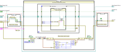

I've been thinking for years that I should write this plug-in, but I never got around to it. Nice work! Here are some changes I suggest making (here's a screenshot that illustrates some of them):
  1. Since you have the W/A/S/D/C/V shortcuts for common alignment operations, I think it would be useful to just be able to type those in the Quick Drop window itself, that way the user doesn't even have to see the pop-up dialog. So with the change shown above (note the use of the Combo Box Text.Text property), I can select controls, Ctrl-Space, type 'A', Ctrl-S, and it will do the left-align without even showing your dialog.
  2. If you end up making that change, you'll want to have a subVI that you can call both in the Align Elements.vi and in the pop-up dialog VI as well. Right now, that code is duplicated in my implementation.
  3. You don't need to close the Panel and Diagram references, since they inherit from GObject. More info about when you do and don't need to close references is in my Brainless LabVIEW presentation.
  4. You should typedef the enum that defines the alignment operations.
  5. You can use case-insensitive matching on the case structures so you don't need to duplicate the upper and lower case keys.
  6. If the scripting code errors out, you'll want to call the Transaction.Fail method, and not wire its error in.

Hy Darren,
thank you for your tips and the link to your presentation. It will improve my code. I've added your requested feature with the combo box to the plug-in.
