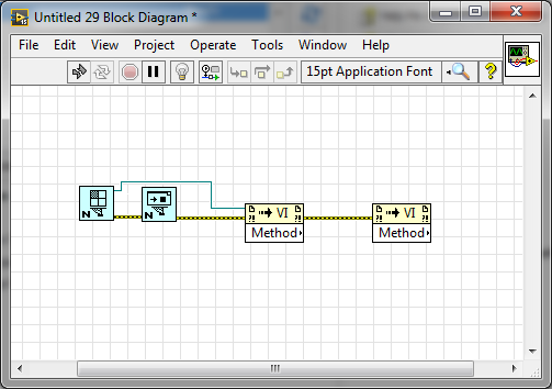

I'll add another oddity I just ran into. In the future it might be helpful to have a single place to show examples of QD not doing what you might expect. In the example below I highlighted the reference and error wires and tried to do a multi-wire insert to add another invoke node. This is something I have done many times before so I was pretty surprised at the result.
(3,796 Views)
Yeah, Smart Insert isn't so smart when a branched wire gets involved. It's an issue that comes up every once in a while that I just haven't had time to fix. I did a cursory investigation a while back and the fix is not straightforward.
