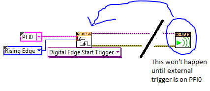

This sounds like a simple start trigger.  There are several examples on how to use triggers in the examples folder.  The triggers all operate basically the same independant of hardware.  You configure the trigger by defining the type and source and then when the trigger is recieved your hardware will begin generation.  It's pretty simple, if this is what you are trying to do.
(4,926 Views)
