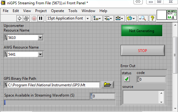

You can use " niGPS Streaming From File (5671).vi"  to do the streaming of your generated file.
You can find it on the GPS Toolkit examples.
