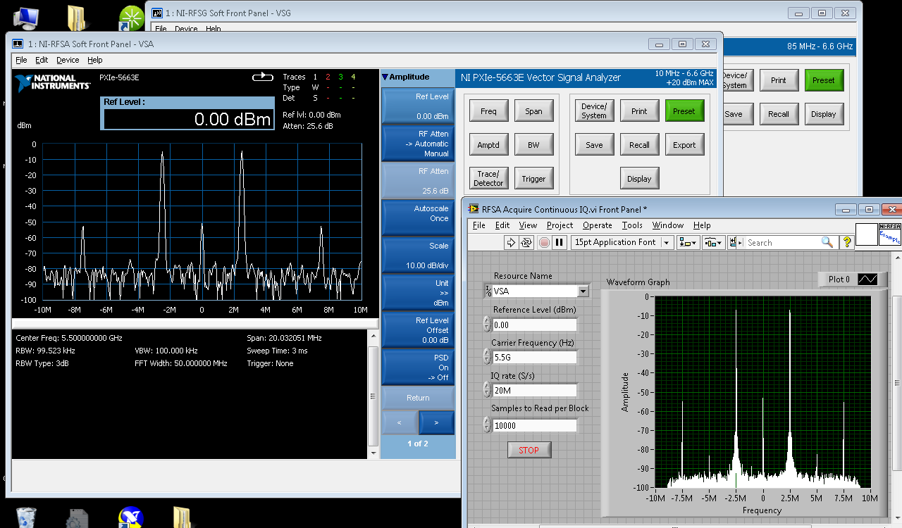

Thank you for the examples.  I was aware that the RFSA can generate the spectrum directly.  However, what I am really trying to understand is why this is wrong:
There must be some scaling of the data that I am missing.  I want to know what the problem is here so that I can avoid it in the future.  The waveform graph displays output that is about 10dBm LOWER than what is displayed on the soft front panel.
Thank you for the examples and other info.  If you can tell me why the above is giving me bad output, I will greatly appreciate it and close the topic.  Thanks for your help!

Hi Brian,
I believe you are seeing this because the SFP is returning the value in dBm whereas the FFT Power Spectrum and PSD VI is allowing you to choose dB or Vrms but not dBm. By returning the value as Vrms (dB On? to False) and then manually converting the peak to dBm then the value was coming out to what I was seeing on the SFP, at least for the few test cases I tried. Digging into the FFT... subVI functions there is a conversion to dB with a reference to "1" that isn't clearly labeled, but most likely isn't 1 mW for dBm. If you want the graph to show exactly what is in the SFP then I would recommend looking at the examples Matt linked above that reference the actual architecture of the SFP and use the Spectral Measurements Toolkit VIs instead.
