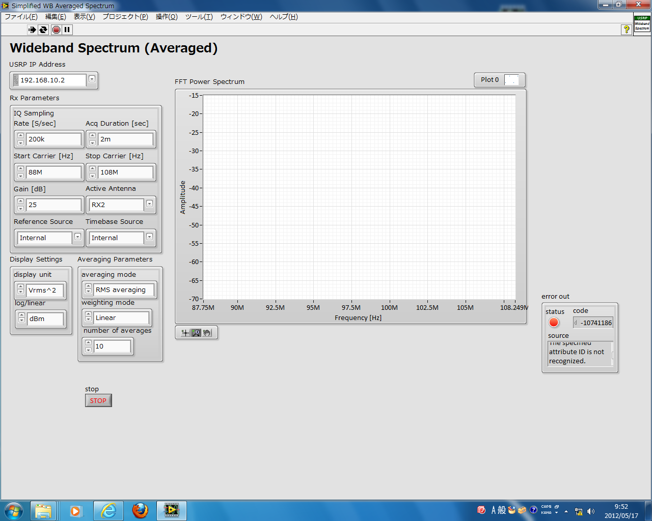

I am facing Wideband Spectrum Sensing problem using USRP2922 in labview2013.........only carrier signal is showing but not receiving actual received signal??Can anybody tell me what is the solve for it??Wideband Spectrum Sensing

You'll want to share some of your code or at least describe it for someone to help you out. Also, please describe your hardware setup as well.
Also, on the screenshot you've shared you've got an error about an unrecognized attribute. Could that be your problem?
