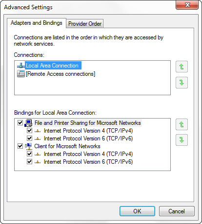

What is the priority order on your network interfaces? It may be possible that MAX is searching the wireless network interface if it's set as the primary in Windows.
To check, open the Network and Sharing Center, and click the link on the left pane entitled "Change adapter settings." (it might be different in Vista; I'm doing this in Windows 7)
Once you click that link, it should take you to the network connections list. I'm guessing it will display the local area connection and the wireless network connection.
We'll need to get at the file menu, which is hidden by default. Tap the Alt key to display the menu bar, and go to "Advanced --> Advanced Settings."
You should be presented with a screen like this one:
Make sure that the network interface that your RIO is connected to is on the top of the list. You can use the buttons to the right to reorder the interfaces.
There are some other troubleshooting steps outlined in this KB and this DevZone.
Hope that helps!

Thanks Caleb,
changing the order of the adapters worked for me! (Windows 7) I had three adapters listed Virtual Wireless(?) , Wireless and LAN. Once I'd demoted the "Virtual wireless" everything worked OK.
Al
