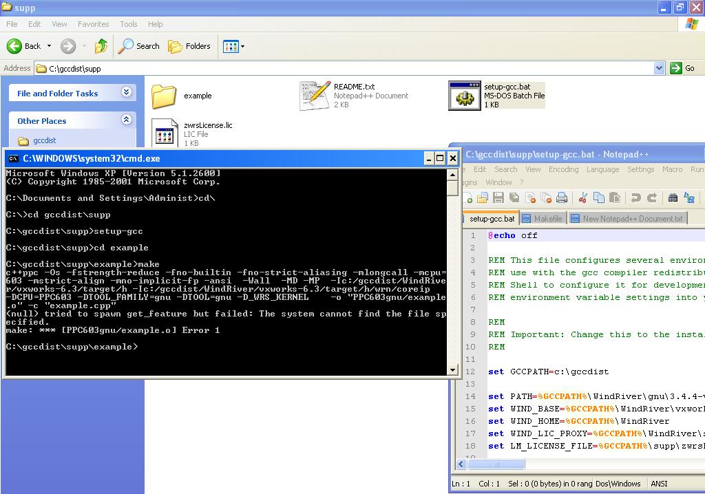

I developed a C++ code, and I would like to call it from a LabVIEW Real-Time application that has a VxWorks target. I downloaded the redistributable GNU tool chain and installed it based on the instructions explained in the literature with “Document ID: 4V1ACUAF” (http://digital.ni.com/public.nsf/allkb/81D1172E3C28A5E4862575CC0076A230). However, It cannot compile the C++ example file and the corresponding error message is as follows:
I will appreciate if someone guide me to overcome this problem.
Thank you in advance

Hi Aldo,
Thank you very much for your answer.
I performed what you suggested; however, it has the same problem as shown in the below picture. Moreover, i change the GCCPATH in setup-gcc.bat and also copy all filein the C:\ , but it doesn't work and the same message appears.
Thank you in advance for your guidance,
Davarpanah

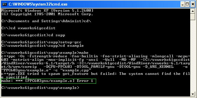

Hi Aldo,
Thank you for your reply
I am sure that this problem is not for a wring path. Because i have investigated many cases with both versions of vxworks61 and vxworks63. But, I examined your suggestion againa and as it is shown in the following figure, it doesn't work.
Have you installed any other C++ compiler or other softwares which is in related to this program?
Thank you in advance for your help
