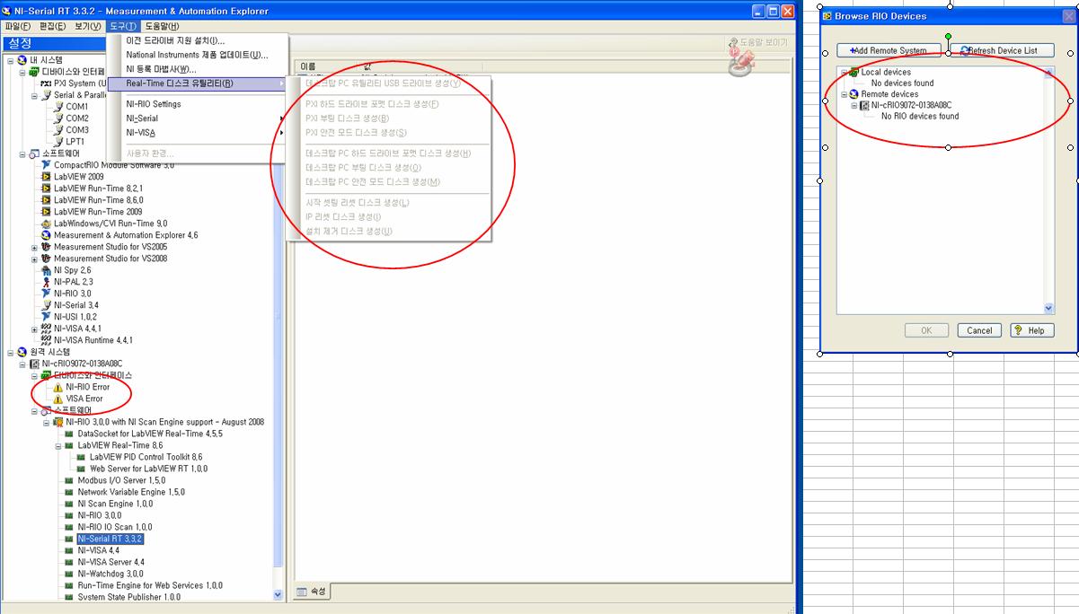

CompactRIO 9072 Device and Interface Error!! Please help me!!
I want to setup CompactRIO9072 as Measurement & Automation Explorer.
But, I met the device and interface errors like the below images.
Also I founded same errors at the RIO Device Setup.
I tried software additional installation for solve this problems.
But I cannot found solution.
What is the problem? Please help me and show me the answers. ^^;;
Please refer to the below images.
Thank  you.

hellow,
cRIO-9072 is Real-time device.
So, You must install LabVIEW Real-Time Module and NI-RIO driver.
LabVIEW Real-Time Module is not free.
You can contact NI Korea through supportkorea@ni.com
