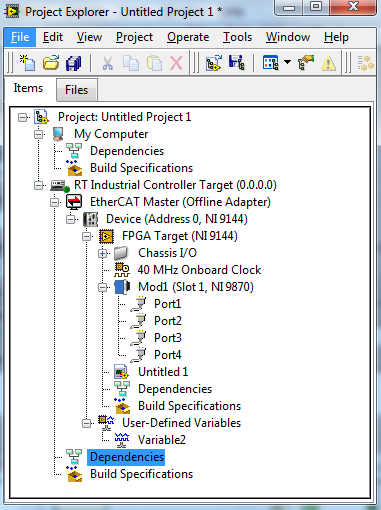

Hi Christoph,
your system in the project should look like this.
The 9870 must be programmed in LV FPGA (using FPGA nodes as in the cRIO example).
The issue is that between 9144 and 3110 you cannot use DMA for the data transferas as it would happen using just a cRIO system.
You have to get your data in FPGA and transfer them to the controller using the User-defined variables as explained in the following link.
Getting Started with Deterministic Distributed I/O Systems
http://zone.ni.com/devzone/cda/tut/p/id/7392
I hope it can help you.
