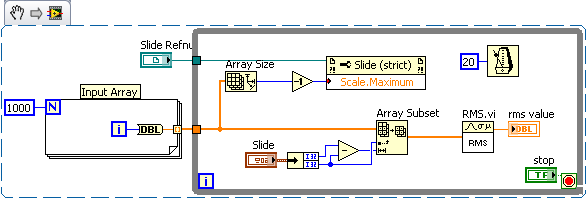

Sean, I agree with Stu that you can use array functions to make a windo for your RMS data. I created a quick example that allows you to use a slider on the front panel to select a window of data.

the question was using the FPGA RMS function.  My reply was to focus on using FPGA memory as opposed to a LabVIEW array construct in re-working the function.
