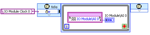

The Sample Clock is a clock exported by the CLIP and you'll need to place the AI node inside of a SCTL that uses that clock. However, the Sample Clock is only available in the most recent version of the NI FlexRIO driver.
If you are using an older version of the driver then you will need to use the IOModClock to drive the SCTL that the AI node resides in. See the image I attached in my last post to see which version requires which clock. If you are using an older version, then I recommend going through the 5733 user guide for information on how to setup the IOModClock.
