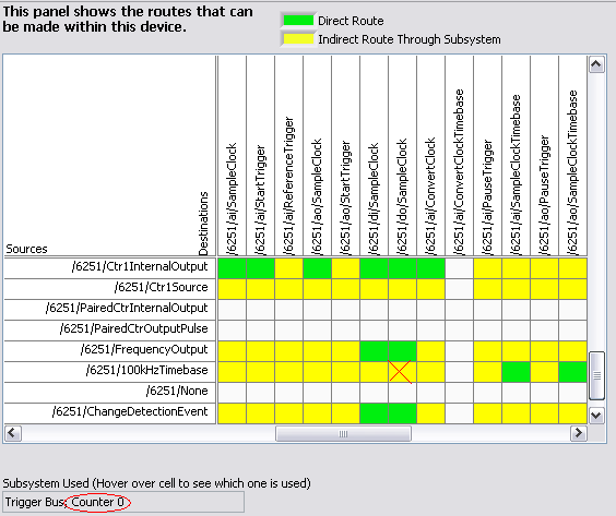

By looking at the Device Routes tab in Measurement and Automation Explorer, it seems that using the 100 kHz timebase as your DO Sample Clock reserves Ctr 0:
You should just be able to change from Counter 0 to Counter 1 on the acquisition side of things to get the code to work (after wiring to the appropriate terminal of course).  If you have any problems with it please don't hesitate to post back.  Thanks!
-John
