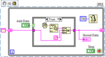

It will only be displayed until you do your next read. If you want to store all the data you can log it to file, or play with the string controls to store data:
The above example adds string data and stores it between iterations.

I figured this topic probably warranted a community example.. so I have made one here!
In the above example we are using a shift register to store data between iterations.  You can add this to a loop structure by right-clicking the border and selecting "Add Shift Register" - alternatively you can replace standard tunnels with shift registers using the right-click menu.
If a value of "True" is read from the Add Data control, the True case will execute.  This generates a random number and uses the "Number to Fractional String" conversion to change to string data type.  We then concatenate a carridge return character and the previous string.  For example;
Previous String - "Second String
                          First String"
Random Number - "0.253615"
Resulting String - "0.253615
                          Second String
                          First String"
