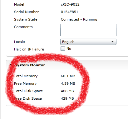

I did a simple test; have a clean 9012 installed with the software and not running any application. Below are the screenshots of the MAX and System Manager. The figures don't seem healthy at all.

Are you using shared variables?  If so how many and what kinds of data types?

In my last post, i just used a 9012 with only NI software installed. I didn't run any of my application.
FYI, i did a memory profile on my application. They are negligible: < 6kb.
As for mem leak, i did 2 steps, first i capture the RT execution trace and found no dynamic mem alloc, secondly i test ran my app overnight and log the system variables, eg CPU util and memory consumption.
Lastly, i uninstalled most NI software and was able to get ~12MB of memory.
Just wanted to share my experience. Cheers! 😄
