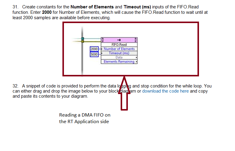

I would always suggest the best place to begin thinking about acquiring data is NI.com/gettingstarted. From that site, you will find an applications section here. In that section there is a link for logging data to disk. This will describe when to use scan interface (in this case you should use FPGA) and how to implement the FPGA code and stream the data back to the RT application using an RT Fifo. Then you can write to the correct USB drive.

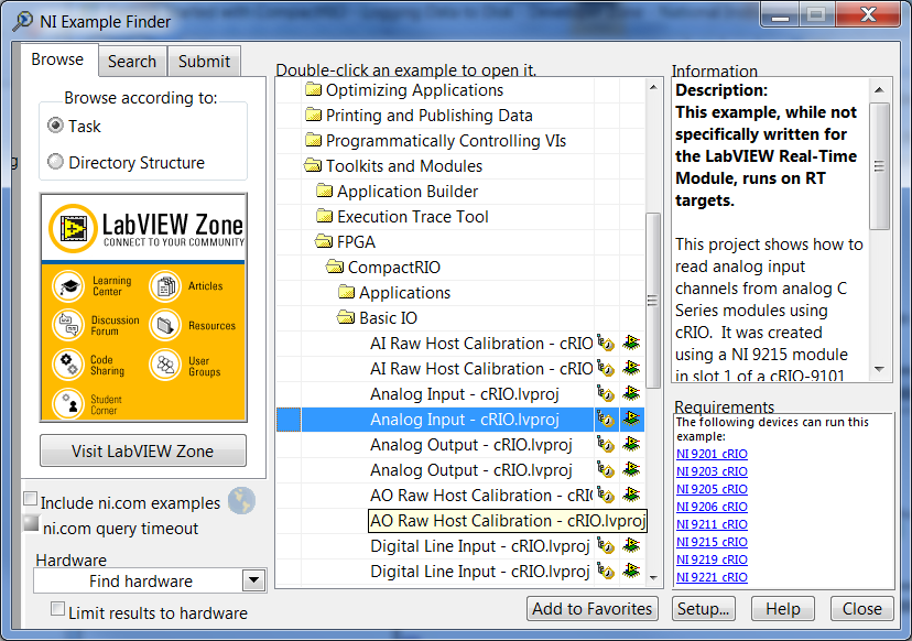

You can also use example finder as a resource under the Toolkits >> FPGA >> CompactRIO >> Basic IO
