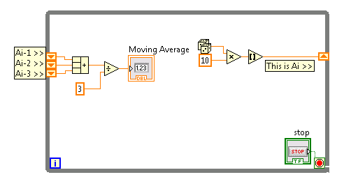

If you're running in a loop, you should be able to use stacked shift registers
See http://www.ni.com/gettingstarted/labviewbasics/shiftregisters.htm
Here's an example
