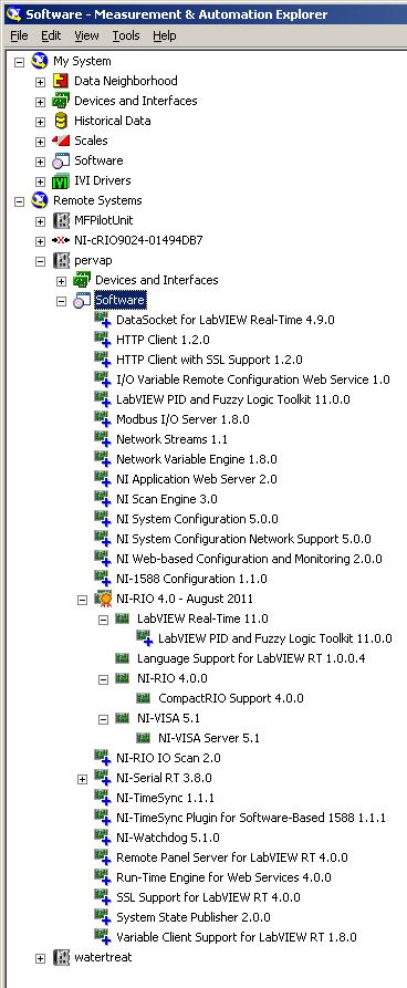

MAX - cRIO software

Good morning Patricia,
Thanks for continuing to look into this.  Yes, the cRIO appears in MAX under 'Remote Systems'.  I've attached a screen shot from MAX, showing the fully expanded tree under Remote Systems.
"System Settings" are viewed through the Silverlight/web interface, right?  If so, yes, I am able to see the System Settings.
