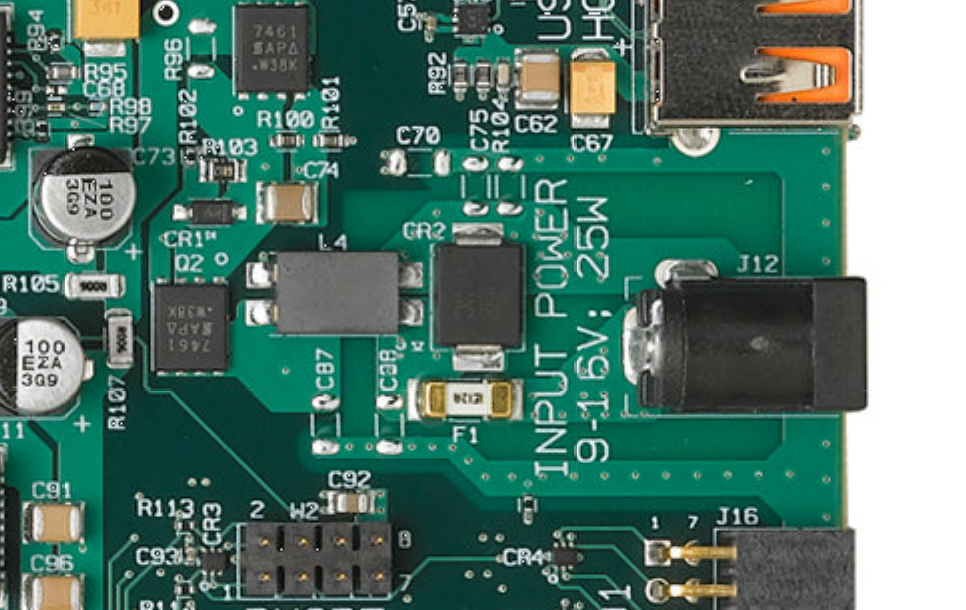

Hi MTO,
The PCB for the Reference Carrier has a silk screen label that references the power input requirements at a high level:
9-16V, 25W.  The documentation for the reference carrier is intentionally lightweight because it isn't designed or tested for deployed systems.  The reference carrier is only intended for desktop evaluation.
