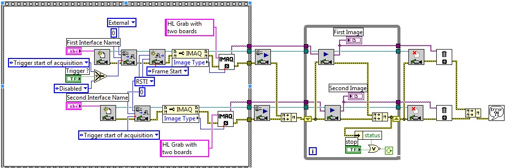

You should be able to synchronize the code you have right now (which works with a start trigger) with another set of code for the second board. There is an example that you should look at; this synchronizes a grab on two different boards. HL Grab with two boards.vi. You can search for this example using the NI example finder: Help>> Find Examples...:: Click on the Search tab, and select descriptions from the pull down (keywords by default). Type the name of the VI and the example should come up.
If you can't find this example I have a screenshot of the block diagram.
Alternatively you could wire the trigger into both cards and copy of what you have already written as Patrick mentioned (just changing some camera aliases) without any problems.
Hope this helps.
<Joel Khan | Applications Engineering | National Instruments | Rice University BSEE>

Inubus,
If you have not modified the functionality of the VI I posted here I don't see why you would be seeing performance issues from a software standpoint. 512mb of memory is a low amount of memory especially if you have other applications running on the machine which could be reducing the memory available to labview further.
You could try to minimize the memory consumption of the VI by deleting the 2 image displays and recording the speed of the loop with the index output. See if that makes any difference.
Is it possible for you to try this on a newer machine?
