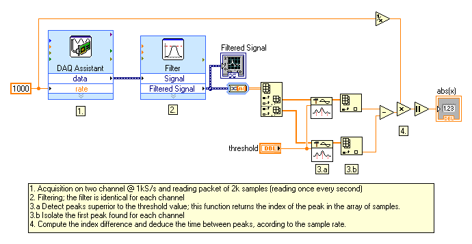

First, the timestamp you generate in your code is not correlated with your acquisition timestamp: The DAQmx driver can provide these informations through a waveform data format. It contains the origin timestamp (t0), the time between two sample (dt) and an array of sample ([Y]). Use the VI Convert from Dynamic Data.
Second, the timestamp value you get in second is coherent: it corresponds to the time elapsed in seconds since the 1st january, 1904. And if you only need the elapsed time between two timestamps, do a simple difference.

You don't need to get time in your code, because you know your sample rate - so the time elapsed between two samples, and you're able to calculate the number of samples between peaks appears on each channel. See the example below:
Hope this helps,
