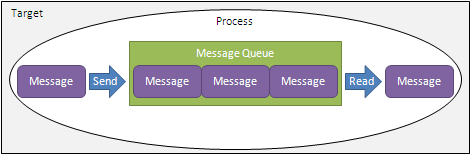

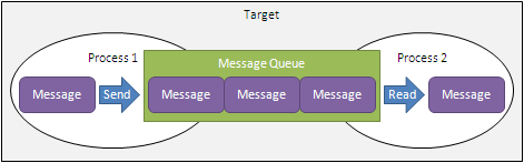

The simplest use of the AMC library is to send a message from one part of a process to another. A common such application is the use of the AMC VIs in the queued message handler (QMH) design pattern which is described later on this article. In the QMH design pattern an event handler such as the UI event structure captures events from a source (the UI in this example) and passes them as messages to another part of the process (the message processor) to be taken care of. Other applications of the AMC in a single process are any type of producer/consumer design pattern.
Internally the AMC library VIs use a LabVIEW queue to buffer messages between the sender and receiver.
Figure 2: Sending messages within a LabVIEW process

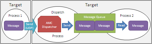

A slightly more advanced use case of the AMC VIs is to send a message from one process to another. on the same LabVIEW target. Messages are still sent through a LabVIEW queue as the same queue can be referenced in both processes. In this case each receiver process will instantiate a named message queue and any other process can send a message to the receiver process using the message queue name. Each sender queue references the receiver process and queue using the queue name provided by the receiver process.
Figure 3: Sending message between LabVIEW processes on one target
For bidirectional message communication between two or more processes each receiver process will create its own receiver queue and any other processes can send their message to one common queue for each receiver. This means that each process only needs one message queue instead of establishing a separate connection between each pair of communicating processes.
When passing messages across the network from one LabVIEW target to another, messages must be passed along using a network transport protocol. The protocol used by the AMC library is UDP as it does not require an established connection between each pair of communicating targets. This allows the AMC library to easily pass messages between any number of targets on a network in a distributed LabVIEW application.
To handle messages sent using UDP at the receiver, each target which will be accepting incoming messages must run the AMC Dispatcher process. This process maintains an open UDP port and listens for incoming messages from any other targets on the network. When a message is received in the dispatcher it is forwarded to the message queue of the local receiver process. The name of the receiver process is included in the parameters of the message itself.
Using this design a process on one target can send a message to any named process on another target in the application. The sender only needs to know the target name (IP address) and the name of the receiver process on the remote target.
Figure 4: Sending messages to a process on a remote (networked) target

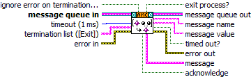

The Read Next Message VI is used to retrieve the next message from the message queue to be handled in the local process. The message queue is passed in by queue reference as it will be created in the same process.
The Termination List input is used as part of the QMH design pattern or other similar message processors. Any message being dequeued which matches any of the names in the Termination List will cause the Exit Process output of the VI to be set to True. This can be used to automatically terminate the processor loop. The default termination message is 'Exit'.

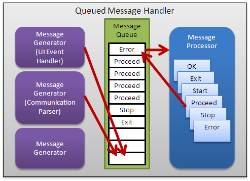

The message queue can be accessed from multiple message generators who all place messages on the queue for processing by the message handler. However, it is common that only a single message generator exists in a particular implementation such as a user interface VI.
In addition to dedicated message generators, processing routines within the message handler may also place new messages on the message queue while processing other messages. For example, an error in processing one message may cause the message handler to place an error message on the queue to be subsequently processed by another routine in the message handler.
During normal operations of the QMH, messages are typically placed at the end of the queue and processed from the front of the queue in a First-In First-Out (FIFO) fashion.
Figure 9: QMH normal operation placing new messages at the end of the queue
In some cases it is desirable that a new message on the queue will be processed as soon as possible. In this case the message may be put at the front of the queue using the Priority Message flag in the AMC library and will be processed the next time the message processor retrieves a message from the queue.
Figure 10: QMH priority operation placing a new error message at the front of the queue

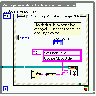

After creating the queue, messages can be added to the queue using the AMC Send Local Message VI.
In the following diagram the queue is created and three initial messages are added to the queue. In the user interface event handler the Write Config File message is added to the queue when the operator presses the Save State button on the UI. The message processor is not shown in this diagram.
Figure 11: Message Queue Initialization and UI Event

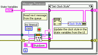

From the queue, messages are read in the message processor loop and then handled by a separate case for each of the messages used in a message handler. The basic message processor includes the Read Next Message VI and a case structure with individual cases for each message.
Figure 13: Message processor loop showing one message case 'Set Clock Style'
The Read Next Message VI includes a few specific features that should be observed in the message processor. The default operation of this VI is to return the next message from the queue and the associated value string and attributes keyed array. The message name is used as the case structure selector for the message processor and the value and attributes may be used in the specific message processor case.
The timeout value on AMC Read Next Message determines when the VI returns if no message is available on the queue. In this case an empty message string is returned from the VI which should be handled in an appropriate case. The message handler template included in the QMH design template contains a message processor case labelled "", "Wait" which is called if there is a timeout on the AMC Read Next Message VI. This message processor case can be used to handle background tasks necessary in the VI operation such as front panel updates, etc. This case can also be called by placing a Wait message on the queue.

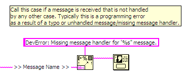

Due to the use of strings as the message name datatype it is possible to make errors or typos when adding messages to the message queue. Any such erroneous messages will not have a corresponding message case in the message processor. Therefore the Case structure default case of the message processor should be used to catch any undefined messages from the queue. Normally any messages passed to this case are the result of a programming error and should be reported as such. Once a VI or application has been completely tested no erroneous message should trigger this message case.
Figure 14: QMH Default Message Case
