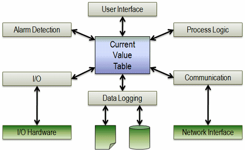

The Current Value Table (CVT) serves as the central data component and can be used in a wide range of applications. It allows other application components to share a common data repository and have direct access to the most up-to-date value of any variable used between components. Using this architecture one component in the application can handle all of the I/O operations and share the I/O data variables or tags with the rest of the application components. Application operations such as alarm detection, user interface updates, process logic, etc. are all handled by separate processes that share the same data repository.
Figure 1: Placing the CVT in context of the application functional blocks

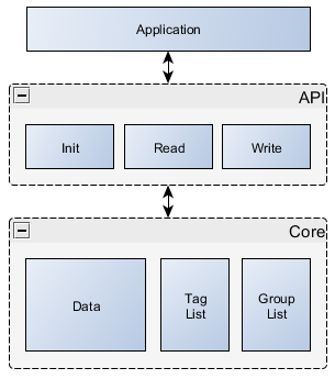

The Current Value Table is implemented in a two layer hierarchy consisting of core VIs and API VIs. The core contains all of the functionality of the CVT, including the data storage mechanism and additional service functions. The API VIs provide access to the CVT functionality in a simple interface. There are three groups of API functions that provide slightly different access to the CVT and vary in flexibility and performance, as well as easy-of-use.
Figure 2: CVT VI Hierarchy

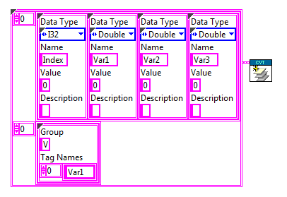

Before the CVT can be used to store and retrieve data it needs to be initialized to allocate memory in the Memory Block and define the variable properties in the CVT Tag Memory. The initialization of the CVT is defined using a cluster array that contains the attributes of the tags used in an application.
Version 3 of the CVT introduces a new cluster which defines groups of tgas in the CVT. This cluster is incompatible with the cluster used in prior versions of the library, but a conversion VI is provided for backwards compatibility. This cluster can be created as a constant on the diagram or loaded from a file. Version 3 of the CVT also adds the ability to create new tags as needed during runtime, without overwriting existing tags. The initialize VI allows the user to select whether or not they wish to clear the C
Figure 5: Initializing the CVT using a constant cluster array

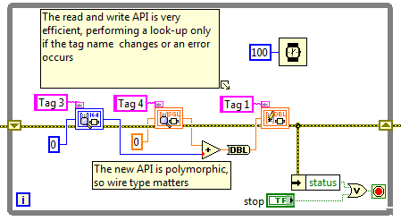

The standard API contains functions to read and write data items in the CVT using the variable name as an identifier. Using the standard API the variable name can be a static string or can be created at runtime using the LabVIEW string functions. In the API call, the variable name is used to lookup the index of the variable and then the value is accessed using the index.
To improve performance, version 3 of the CVT only performs the lookup on the first call, if the lookup previously failed, or if the tag name input changed from the previous iteration. This API uses polymorphic VIs to switch between data types. For writes, this data type is selected automatically based on the wire type. Reads can be selected by providing a default value or by manually selecting a type. The appearance of the VI will change based on the instance selected.
Figure 7: Example accessing different CVT variables using the basic API

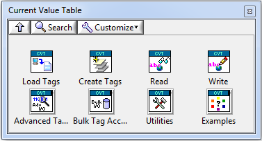

All of the basic API functions, including the initialization VI, are contained in the main CVT function palette which is installed in the User Libraries function palette in LabVIEW.

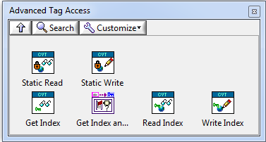

The Static API (Static Write.vi, Static Read.vi) is very similar to the basic API. However it requires that you use a static name (constant string) in your application when accessing a variable. This restriction allows each instance of the Static API to only perform the variable index lookup operation once on the first call to each instance. It then buffers the index for subsequent accesses providing a significant performance advantage when repeatedly reading or writing the same variable in the CVT. The Basic Example shows how to use the Static API.
The Static API functions are available in the Advanced subpalette of the main CVT function palette.
Figure 9: CVT Static API Function Palette
The Index API is an extension of the Static API and provides even better performance. Using the Index API you use two VIs to access a value in the CVT. The first VI is used to retrieve the index of a variable (Get Index.vi) in the CVT. This step is only performed once for each variable used. Then the index is used to access the variable value (Write Index.vi, Read Index.vi). This provides the thinnest possible API to repeatedly access the same value in the CVT. See the Advanced Example for how to use the Index API.
Figure 10: Example using the CVT Index API
The Index API functions are available in the Advanced subpalette of the main CVT function palette.
Figure 11: CVT Index API Function Palette

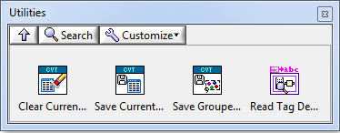

The Utilities API functions are available in a subpalette of the main CVT function palette.
Figure 12: CVT Utilities API Function Palette
