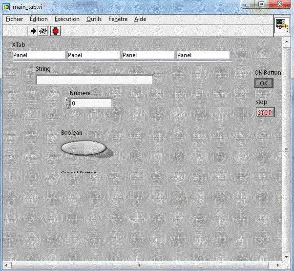

Hi all,
I use Labview 2010 and the 'ViBox - XControls' downloaded from https://decibel.ni.com/content/docs/DOC-21668.
After creating a project including my VIs (in which is used the Xtab control), the corresponding executable file presents some bugs. As seen in the screenshot of my application, the graphical design of the tabs are different and there is no more the button to close the tabs. In the project, I only added my VIs (main VI and sub-VI). Do I need to add additional libraries, VIs, controls, etc.
Any suggestions.
Thank you.
Cédric

Hello Cedric,
You need to put pictures resources used to render the page in a directory named "Resources". I think that default settings of your build specification copy them to data directory.
Note that you can find a project (pictureViewer.lvproj) in the Example Finder that shows you a working build specifiaction.
Note that we've been working on a new version of the XTab that will improve the building process of application that use XTab.
Olivier

Hi Olivier,
Thanks a lot. It works now!
