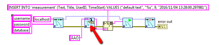

Hi Jonatan,
I think you have to convert your "LabVIEW String" to a UTF8 encoded string by using the "Convert string to UTF8" VI (You will find this VI in GDatabase for MySQL palette -> Utility).
Example :
When you get back data from MySQL server you could have to convert UTF8 encoded String to a "LabVIEW String" by using the "Convert UTF8 to String" VI.
I hope this will work, please let me know,
Yannis RICHARD
(5,839 Views)
It works! Thank you. I was looking for options in the Insert block itself, but now it works. Thank you for the fast response.
