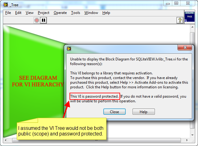

Hi There,
I was testing out the new SQLiteVIEW toolkit (v1.0.0.38) and was surprised that the VI Tree was password protected, especially since it's a public VI of the library.
Was this intentional or an oversight?
-Jim
BTW: Great job packaging this up with VIPM.  I like the integration with the LabVIEW 2010 add-on activation manager.
(6,680 Views)
Accepted by topic author Jim_Kring
Hi Jim,
Actually, this is both intentional and due to an oversight.
This intentional because in the state of the "development" of the VI tree, I think he won't be helpful for end-user.
This is an oversight because, as you notice, it's a public VI, so if I don't want to expose it I should not add it to the package.

Hi Olivier,
Thanks for the info.  I would just make the VI Tree "private", if end users are not intended to be able to access it. (Since this will hide it in the library, since the library is locked.)
If you do want to make it available to end users, I do like putting it in the functions palettes (as is commonly done for instrument drivers).  I do think that they can be helpful, if organized properly.
That said, the value of a VI Tree is somewhat diminished, now that VIPM makes it so easy to get VIs in the palettes and install examples.  So, maintaining a VI Tree can be a bit redundant.
