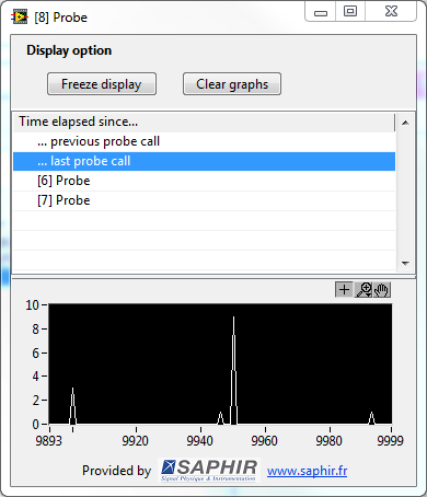

| Chronograph |
Supported wire type :
Description: The Chronograph probe measures code time execution:
It's a powerfull tool to quickly analyse code execution in your program. |

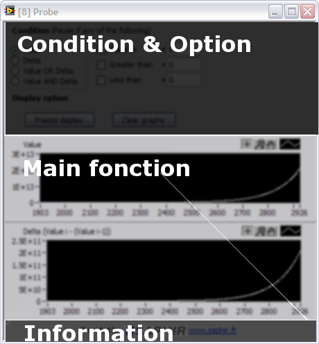

| Delta |
Option & Condition:
Display option: Stopping condition: Freeze display Value Clear graph Delta Value or Delta Value and Delta |
Description: The Delta probe displays evolution of current value monitored in the first graph and evolution between current value previous current value in the second graph. It's a powerfull tool to check delta evolution of numerics. |

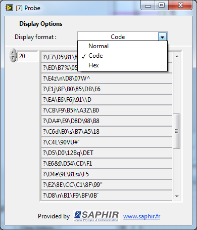

| Normal / Code / Hex Display |
Supported wire type : |
Option & Condition:
Display Option: Normal Code Hex |
Description:
The Normal/Code/Hexa display probe displays string in 3 different display mode:
Additionnaly the string size is calculated and diplayed in the bottom part of the probe window. |

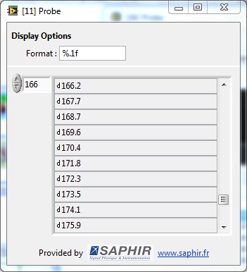

| Resizable Array |
Note that 1D and 2D array are supported. |
Option & Condition:
Description:
The resizable probe displays data in an array that shows more or less cells depending of the probe window size. This is a powerull tool to navigate through an array and see values next to the monitored index.
Note that you can change the display format for numeric an string data type |
