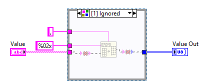

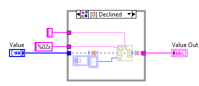

For the following use case we use the new "Type Specalization Structure".
Now its possible to flatten/unflatten special strings with just one VI.
This is how the other case looks like: (No file snippet)
And this is how a converted instance for "Flatten" can look like:
