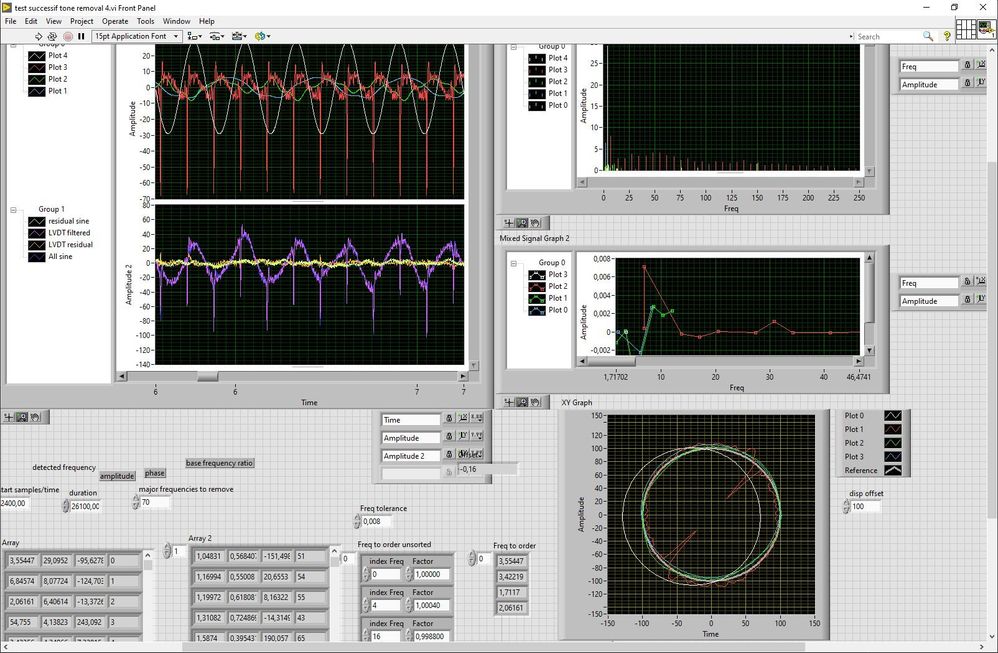

So here is my pause play (Q&D ) up to you to play now 😄
Took the LDVT signal and applied sine fits (tone detections)
picket n=4 frequencies (manually tweaked a little, to match orders at higher freq )  and sorted all found sines to nearest order or residual (>Freq tolerance)
If a sine match I coerced the freq to the order and map it to XY chart ...
One frequency at 149.xx Hz I assume is due to a motor 😉
Greetings from Germany
Henrik
LV since v3.1
Message 7 of 9
(5,100 Views)

Matt,
your picture and task description is based on a lot of simplifications ..
Based on my experience and data you provided, here are some points:
Your sensor is (at least) a mass (small roll, sensor tip) spring (pushing to roll to the wire, and the wire itself) system , measuring the mass distance... hey, you have an accelerometer 🙂  so surrounding floor and maschine vibrations will be picked up, and you have a resonance and more effects ...
If I look at the spikes in the sensor signal I already can imagine the sensor roll jumping and 'ringing'...
As I already asked: You have 2 pairs of rolls.. how are the pairs coupled?
How sensitive to floor vibrations are the wire forming rolls? Are there other vibration sources nearby?
I bet these vibrations will be seen in LVDT signal, wether by real inprint by the rolls or by the 'accelerometer'.
So I took the LVDT signal and looked for the major n (20-200) sine frequencies in that signal. (This could be done with a single FFT, but the tone detection already have a 'inbetween bins' correction).
So we have an array S_n of  frequencies, now we have to sort this array. If we find frequencies that are harmonic to another,we can assume that these belong together to one 'roll'  or source aka base frequency.
So I started to sort the elements of S_n to groups of harmonics or residual (noise) based on a threshold. I bet there exist already a nice algorythm to find these frequencies ... (linear fit??) .
I simply hand picked four base frequencies, two have quite big amplitude, but no or nearly no harmonics. (only low frequency contend) I assume that these are due to vibrations that couldn't  be filtered by simple mechanical (rubber/air pring based) dampers (that's hard for frequencies below ~5 Hz .. one would use tuned mass dampers)
the other two could be seeen as due to the rollers ..
1. What are you stating to be the final signal?
two of the four xy-chart plots.. , maybe the sign has to be changed..
2. How are you removing higher frequency components that recur for each roller?
I don't remove higher content, I just look for the major signal parts 😉
One could argue that, as long as the residual signal is in a acceptable noise band (RMS value?) the number of selected and removed frequencies is fine 🙂
3. How are you selecting the "freq to order unsorted"? What decisions are you making?
Match as many harmonics as possible?
I plot the 'diff' to nearest harmonic, and hand matched the frequency...
Is the frequency within a threshold limit to a multiple of one of the choosen base frequencies? If yes, choose the base freq. with the lowest diff. or put it to residual. See diagram
4. Where are you visualizing the removed frequencies?
in the graphs, have look at the diagram ...
For every (major) frequency found there is a physical cause, it's up to you to find it.
Harmonics are simple , but since metal forming is a nonlinear process there are some mixed frequencies (sum or differences) of (harmonic) base frequencies.
And remember to analyse external causes (vibrations)
Still some work to do 😄
Henrik
LV since v3.1
