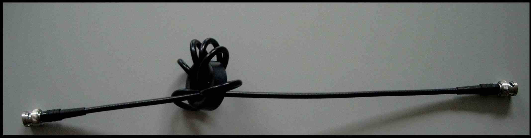

A central ground close to the 9215 can help. the +-15V should really be floating and the ground should have a close connection to central gnd.  (However see sig 😉 )
Adding chokes like this one at the 9215 input: A nice ferrite core and a BNC cable ,
can help too, but they work best for two wires, (shield??) .
You said shielded twisted pair, how is the shield connected?

Sorry I misspoke earlier.  I'm using BNC cables for both connections like the ones in the picture you showed.  The +/-15V supply is floating.  I have connected the grounds of both sensors to earth gnd using T-connectors and BNC connection to my o-scope as SteveD123 suggested.  I assume that in your comments central=earth ground?  Obviously using the o-scope as I'm now doing is not very direct.  Do you have any other suggestions.  I have installed ferrite cores on both cables on the NI 9215 side as you suggested.  That along with grounding the AI- of each channel seems to have helped tremendously.  Thanks.
