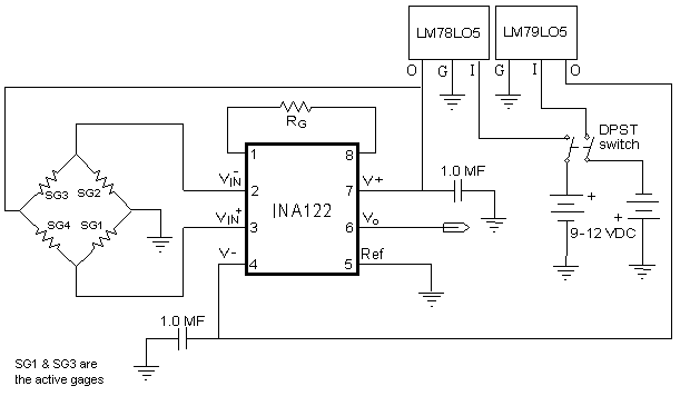

I got an amp circuit set up. I used a 620ohm resistor to amplify the signal about 327x. I am now running on the recommended excitation voltage with a 10V regulator putting out about 10.25Vdc.
Right now I have my USB6009 reading the INA122 output to the first differential input and reading the excitation voltage to the 2nd differential input. Right now I'm getting around 1V output at 50lb load (500lb FS capacity) but am still experiencing significant noise since my calculated lbf output is jumping between 0.2 and -0.2 at zero load. I have not performed any software filtering and am using the excitation voltage reading for the calculation of the lbf output. I have not trimmed my resistors or anything yet so maybe that will help.
Another thing is I am powering my voltage regulators with a regulated 12Vdc wall power supply (from 120VAC line in house). Since I will be using this at a swim pool I plan on using series 9V batteries to supply 18V to the circuit instead of the wall power supply. Maybe this will also reduce the noise...
I plan on going through the information in this post https://forums.ni.com/t5/Multifunction-DAQ/USB-6009/m-p/784834 and hopefully get the noise level down.
Two things that I am curious about still... I see on some load cell circuit schematics that the people are takign the +10V and -10V signals that power the  INA122 and wiring them to a small capacitor and then to ground. Will this help with system noise as well or what does that accomplish, here is an example of what I'm talking about
http://www.nakka-rocketry.net/strainlc.html
My other inquiry is that in tension my labview program is reading beyond 50lbf but in compression it stops at around 45lbf or just under -1Vdc output. What is the maximum differential voltage I can input to the USB 6009? Am I limited to +/-1Vdc? I thought it was +/-10Vdc.

Hi William,
The capacitor from V+ to ground is meant to filter out noise. You can check out the specs for the USB-6009 on it's product page. It does have a max voltage range of +/-10V.
Rohan B

Well that makes alot of sense and it worked well. I have it all working well now. Might go ahead and switch to battery power for convinience at the pool in the end.
